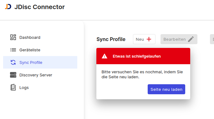

Sync Profiles not displayed / error message
Symptom: Under "Sync Profiles" a red error message appears instead of the profiles, or the list is empty.

Sync profiles can be created but not opened (json_decode error)
Symptom: A sync profile can be created, but opening the profile or the profile list shows the message "Seems like something went wrong - Please try again by reloading the page." The profile remains selectable when synchronizing an object. The Apache error log contains an entry of the form:
PHP Fatal error: Uncaught TypeError: json_decode(): Argument #1 ($json) must be of type string, null given in .../synetics_jdisc/src/Model/JDiscProfileDao.php
Cause: When an object type assignment is saved in a profile without a port filter, the corresponding database fields remain empty (NULL). When the profile list is displayed, these fields are read and trigger the error.
Solution: Set the empty port filter fields to an empty value. Please create a backup beforehand. You can find the database credentials (user, database name) in the config.inc.php of your i-doit installation; adjust the user and database name in the following commands accordingly.
mysql -u idoit -p idoit_data -e "UPDATE isys_jdisc_object_type_assignment SET isys_jdisc_object_type_assignment__port_filter_type = '[]' WHERE isys_jdisc_object_type_assignment__port_filter_type IS NULL;" mysql -u idoit -p idoit_data -e "UPDATE isys_jdisc_object_type_assignment SET isys_jdisc_object_type_assignment__port_filter = '[]' WHERE isys_jdisc_object_type_assignment__port_filter IS NULL;"
After running these, the affected profiles can be opened and edited again. A permanent fix is planned for an upcoming version of the JDisc Connector Add-on.
