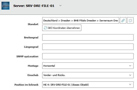

Objects are assigned to a parent location object via the Location category. This creates the hierarchical location view.
Assigning a location
- Open the object to be assigned to a location
- Switch to the Location category
- Select the desired target in the Parent location field (e.g. a room or server rack)
- Save
The object will then appear in the location view below the selected location.

- Using List editing, multiple objects can be assigned to a location simultaneously
- In a server rack, objects can additionally be positioned on specific rack units
- Location assignments can also be made via CSV import and the API
